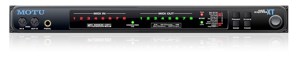

This is the version they are marketing now:
This is mine. I guess it is an early production unit.
I personally like the way the panel is arranged on mine better. However, I had always assumed that the later version was functionally identical. Apparently, it's not.
