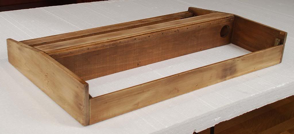

I got more work on the refinsh project in today. First, I took some 150 grit sandpaper and worked on the burns from the heat gun:

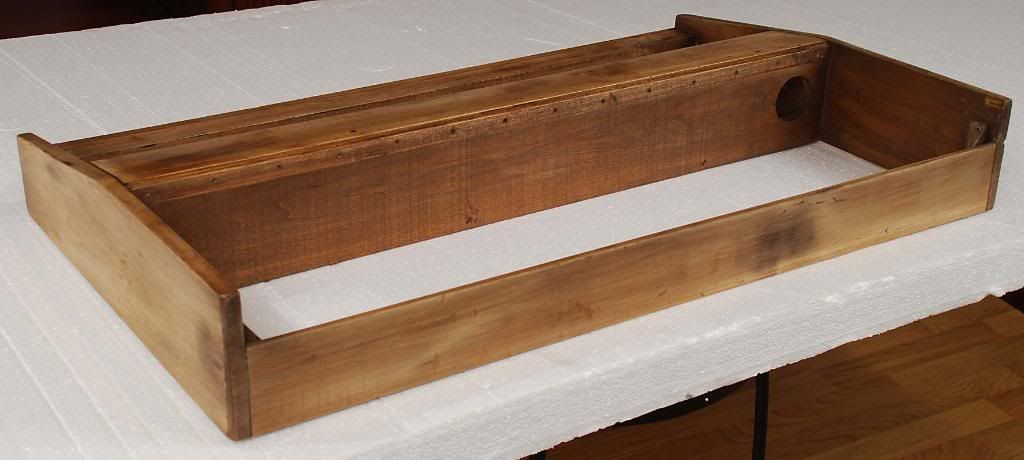

I then took some 220 grit sandpaper and snaded the whole chassis:

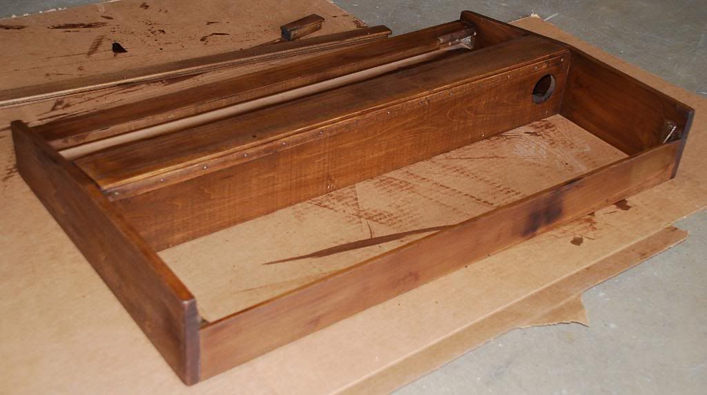

I then brushed Minwax Special Walnut stain to the chassis, inside and out:

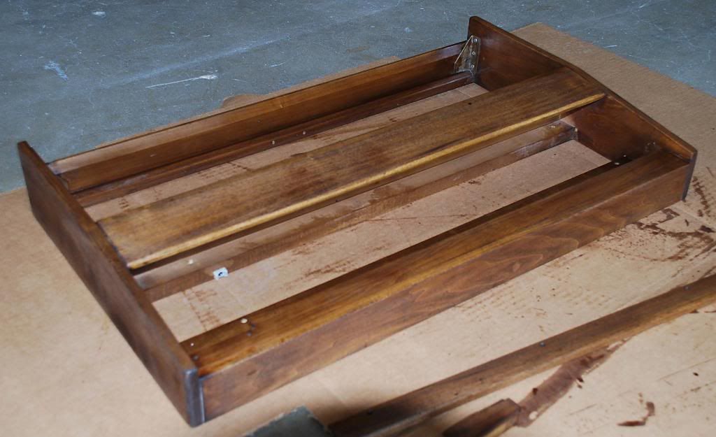

After wiping off all the excess stain, I sprayed on a couple coats of clear semi-gloss lacquer:
I'm letting it dry in my warehouse over the weekend. I'll probably put one more coat of lacquer on before I call it finished take the chassis back to Audio Electronics to have it reassembled. Don't look too bad, does it?

Nice work. I think the burning blended quite nicely, where it adds a touch of character. Kudos!

nice! i'm glad you went to refurb rather than replace route, it's got character!

Nice. In the picture you can't even tell it's a burn mark on the back, unless you saw the first pictures and read the thread.
On the initial pictures it had a sort of wild west look to it for some reason. Kind of rustic. Turned out great. Now we wait for the final assembly. :D

Turned out fine, good job. A lot of wood can display natural dark characteristics like those burns. I doubt someone who didn't know or wasn't into woodworking would even have a clue.
