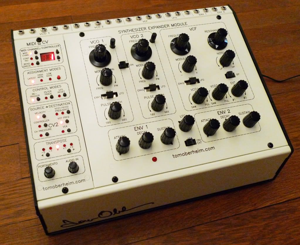

Don't think anyone else has posted about the new pro midi patch panel version...
edit: got rid of the picture as there is one below now. Go to tomoberheim.com if you need to see it.

- soundxplorer
- Posts: 280
- Joined: Wed Sep 05, 2007 4:48 am
- Location: PA
Re: The New Tom Oberheim SEM Thread
I just got my SEM Pro a few days ago and so far I'm loving it, especially in Band Pass mode. This thing is full of "sweet spots" to explore. It just sounds good all over the place. I went with the Pro because it will be used with a small Eurorack system, but I also need a MIDI converter. I like the one-button-per-function of the built-in converter, plus the preamp will be useful. It's going to serve as an "expander" for my Little Phatty - a retro-vintage combo.
