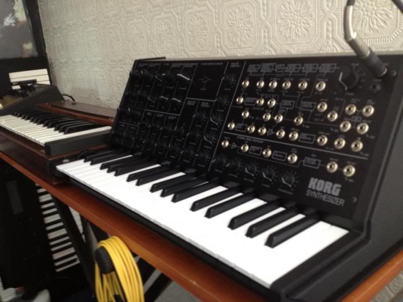

My MS20 Mini arrived yesterday!
After 4 hours of programming its safe to say i'm in love with the thing! Build quality is excellent with no wobbly knobs (at least on mine), and the sound is extremely close to the original. This is undoubtably an MS20 :)
