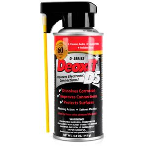

Honestly, with time I have found that most of my problems could be solved by :
Fixed my Juno 106, Matrix 1000, MKS-50, rack mount amp scratchy volume pot with that.
Fixed my Yamaha A3000V2 and TC Electronic G-Major skipping encoder with that. (Even DSI sends you a tube to fix their faulty encoder on some of their old synth batch).
Fixed my old doorbell
Like the other said, update the OS, do a factory reset. Caig Deoxit the volume knob, the pitch bend wheel and the faulty knob and everything should be okay. Also, sometime when synth do not get used often, we need to give them a knob workout. My Mono Evolver keyboard does that.
