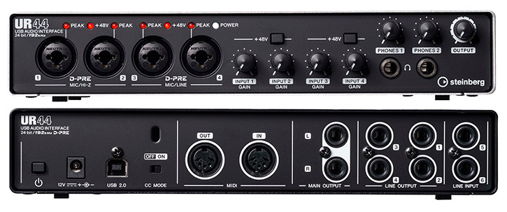

Looks like the OP was trying to run the synth and drum machine through the UR44´s mic inputs instead of the line inputs on the back, hence the bad sound so far and the idea a higher end mic preamp will cure it.
Apologies if I´m wrong.

See, the first and second inputs are for mic/guitar only.
Herrare umanum est.

varun213
Posts: 58
Joined: Thu Dec 17, 2015 3:18 am
Re: High end preamp ideal for P8?
Post by varun213 » Fri Jan 29, 2016 10:34 am
Mooger5 wrote:See, the first and second inputs are for mic/guitar only.
I use line 1 and 2 for the Prophet '08..would you say I got in the back? does it even matter?

Post by varun213 » Fri Jan 29, 2016 10:40 am
Mooger5 wrote:Looks like the OP was trying to run the synth and drum machine through the UR44´s mic inputs instead of the line inputs on the back, hence the bad sound so far and the idea a higher end mic preamp will cure it.
holy s**t thats exactly what ive been doing. Never knew the mic inputs are bad for Analog synths. If thats what you're getting at?

Mooger5
Posts: 1459
Joined: Tue May 06, 2008 5:11 pm
Location: Lisbon
Post by Mooger5 » Fri Jan 29, 2016 12:20 pm
varun213 wrote: I use line 1 and 2 for the Prophet '08..would you say I got in the back? does it even matter?
varun213 wrote: holy s**t thats exactly what ive been doing. Never knew the mic inputs are bad for Analog synths. If thats what you're getting at?
That´s it, inputs 1 and 2 aren ´t line inputs. I´m not saying mic inputs are bad for analog synths, it´s rather the opposite: the mic pre expects very faint signals and a line level signal will overload it, making the synth sound distorted. There´s a proper way to set things up first, only after that less orthodox aproaches should be tried.
I´m all for adding tone and character to any synth that could otherwise sound bland in some specific situation. There are equalizers, compressors, pedals, even crappy old mixers will colour the sound in some way.
Good luck.

Yay! Problem solved.
