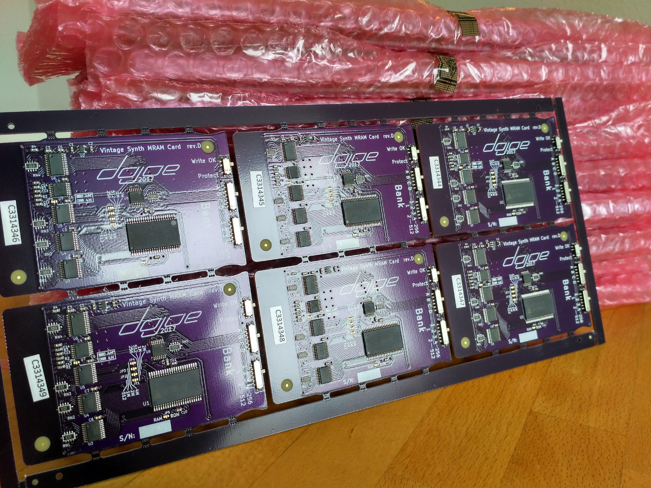

168 memory cards, assembled but still on panels. I'll have to find the time now to perform the final assembly steps (break the cards out of their panels, add guard wires to protect the slide switches, configure the cards into 8x512 or 16x256) and most importantly test all those cards. Once I've got enough stock of completed cards, I can start taking orders -- around the end of September maybe?
Thought you might like to see this :)
