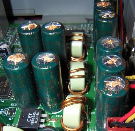

Personally I think its always worth having a go at saving stuff, you have nothing to lose but your time so if you have the time give it a go. Usual rules apply though, make sure its been off and unplugged for half hour before you go rooting around inside.
The description of the sound makes me think its a popped capacitor, most likely around the PSU area, sometimes they are really obvious but often they can be quite subtle, look for the end cap being split open as it heats up and vents, hence the pop and then the smell.
All of these are failed :-
Obviously it could be anything really and its quite possible a fail will then blow a fuse as well.
