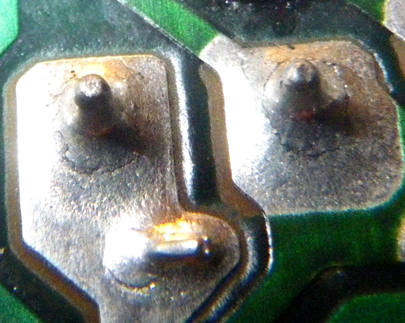

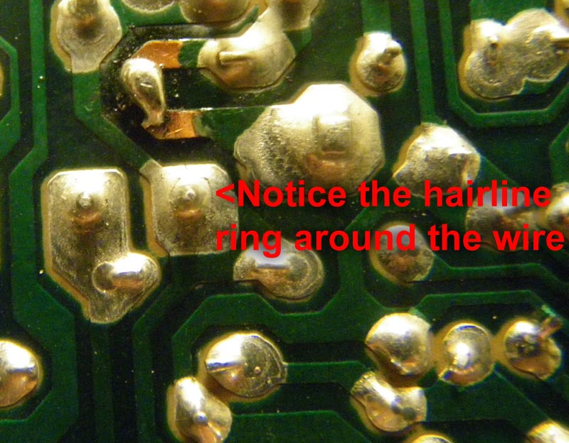

I have no idea of people's skills or handiness with a soldering iron but I knew I had this image handy (from an old car fuel pump relay) so in case anybody reading doesn't know what a dry joint looks like :-
