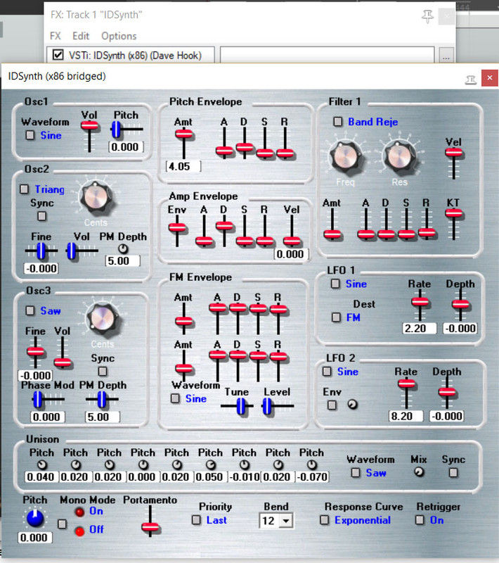

Ok, a pitch envelope is not that common so I googled for a free VST one just so I could show you. Its very rough but all I did was create a pitch envelope that roughly matches (high mod/amt, very short but non zero attack, shortish decay with no sustain or release), mucking around with a filter will get closer.
Here is the sound I made (ignore the vid, youtube insists):-
Using this free vst plugin:-
http://www.freesoundeditor.com/download ... _beta2.rar
The synth is nothing to do with me its just that it has a nice simple pitch env to muck around with so I could give you an example.
Here are my settings, and you play roughly a C1 note.
PS, you caught me on a night where I am very bored and looking for random things to do :)

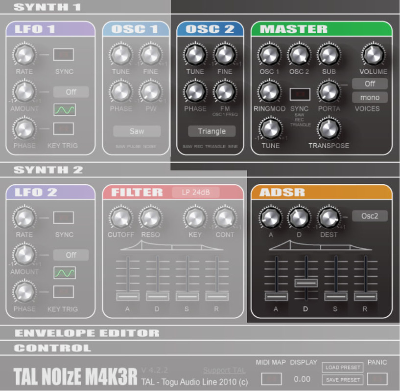

Kentronix
Posts: 33
Joined: Sat Apr 28, 2018 9:39 am
Gear: ABL3. Waldorf Rocket, MicroBrute, Volca Bass x 2, Volca Keys, Volca Beats, Rhythm wolf, Boss DR-550, Korg Delta, Yamaha DX-11, Roland D110, Reaper DAW
Re: I can't reproduce this sound !!
Post by Kentronix » Fri Jan 04, 2019 12:44 pm
madtheory wrote:TAL Noisemaker is a free VST synth where you can send envelope to pitch. It's probably the best synth out there for learning synthesis. Works on Mac, and even on Pro Tools.
Nice, not seen that before what a nicely laid out synth. I use the TAL bassline for sh101 style stuff but obviously it has no pitch env.
I knocked up a sound on noisemaker, all left as defaults apart from the non greyed out bits here, OSC2, Master and ADSR. Playing a D3 note is roughly right, its a starting point anyway.

madtheory
Posts: 5142
Real name: Tomas Mulcahy
Gear: Flangebeast Mk1, Plonkotron, Morovdis Arpeggiator, Maplin My First EQ, Jeff Wayne Thunderchild rack, Thermostat, Buck Owens' Moog.
Band: Minim
Location: Cork, Ireland
Post by madtheory » Fri Jan 04, 2019 11:45 pm
Awesome! Yes it is well laid out. And it sounds pretty good too. Dual LFOand dual PWM FTW!
