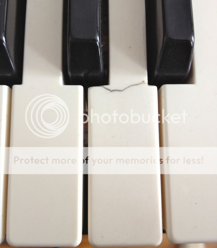

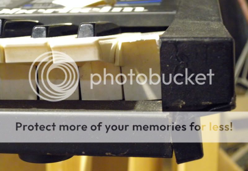

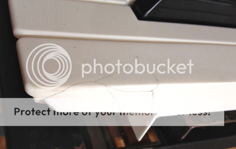

Both plastic end-blocks are cracked, the highest C key is broken and the lever deck has it's underside stand-offs all broken off.
The Chassis is bent but I think I can straighten that out.

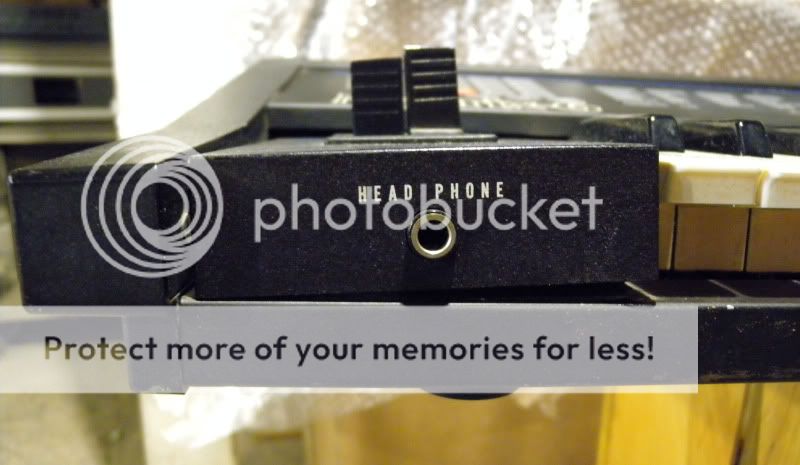

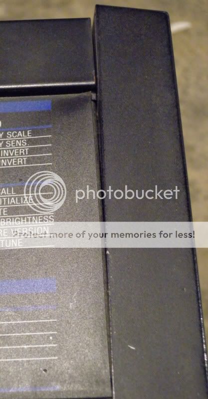

Here are some pics of the crime scene:

That is sad. From those pics it looks as if it couldn't have been packed very well at all. And if it was, UPS didn't treat it very good either. I would definately be all over them on that one. Was it insured for full value? I would file a claim with them anyway, I think they cover $100, maybe a bit more, without additional insurance. It would be something at least. I hope everything works out for you.

Uggh! That is really quite sad to see.... if I were in this position, assuming you can't get it replaced on insurance, I'd remove both end cheeks, carefully straighten up the metalwork, and have some nice polished wooden end cheeks made. There are a number of companies that make custom end cheeks now and they can look very posh. The bender panel could possibly be repaired until you can find a replacement and yes I -highly- recommend Bob at Sounddoctorin' for replacement keys - it's thanks to him my EII has it's top and bottom C-keys in place after a similar nightmare with a courier. Many keyboards share key mechanisms - eg. EII and Kawai K4 and so you can often find a more common, lesser mortal, as a key donor.
I'd be most concerned as to whether the pcb assemblies are ok and that the keybed is still straight. I hope to christ the mains transformer is mounted to the chassis in the Matrix and not to the pcb!

I have the keybed disassembled for cleaning and plan to piece the top C key back together with CA glue until I can find a replacement.

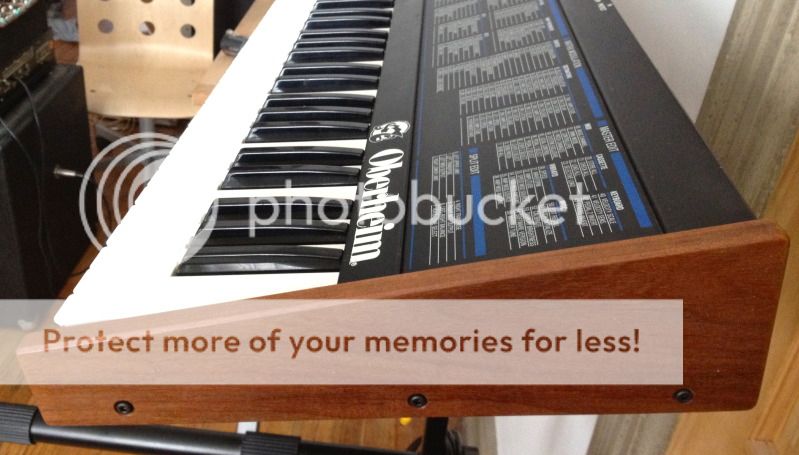

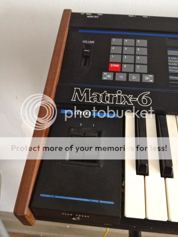

Working on end-block/cheeks for my Matrix 6...
I went with simple instead of copying the shape of the plastic ones... that would be silly since I sorta feel like the should have looked like this in the first place. still need to fix the keys and clean the s**t out of this thing... it's been in the shop for a while collecting dust.
Makes it look more "OB" doncha think?
These cheeks are made from ipê wood. It's a bit heavy but it'll look fantastic and hold up to abuse.

VSE Review Contributor
Posts: 2889
Re: HELP! UPS Smashed My MATRIX 6
Post by nathanscribe » Tue May 17, 2011 2:19 pm
Looking good so far!

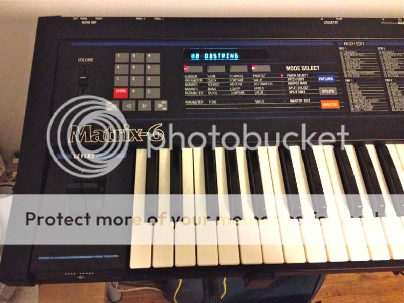

FINALLY DONE!
Made Ipe wood end-blocks as well as refurbed some replacements I came across. works like a champ.
Had to completely rebuild lever box... replaced battery, reinstalled software/programs, etc.
Post by nathanscribe » Mon Mar 12, 2012 10:37 pm
Nice work. Let's hope you like the thing now..! I had a 6R for a while, and although it sounded good I didn't enjoy programming it - I often wondered if the keyboard version would be easier with the parameters clearly displayed on the panel. I know I could just have printed off a parameter sheet, but the ergonomics are different.
