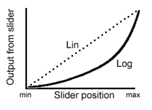

This is how yours should respond: left to right is slider position -5 to +5, down/up is positive to negative output, or quieter to louder.
EDIT: the previous image was mildly confusing. This one´s better.

Note the discrepancy at 0: mine is normal and at 0 is still a positive voltage, whilst yours is already going negative.
Please remove that molex connector from the main board and now measure the voltage change directly at pin 5 on the main board. What voltage do you read with the vca level slider at zero?
