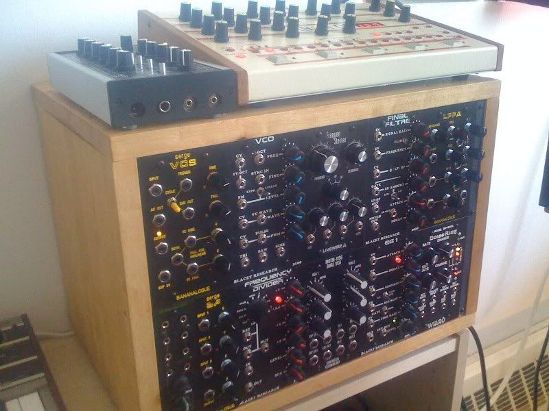

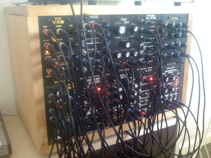

FWIW, I also opted for the DIY route for my Frac modular. I wanted a case that was small- intentionally so, as to force myself to learn the ins and outs of all of the modules I chose for the system. Even when the first box was completed, modules such as the Bananalogue Serge-based designs allow for multiple uses of each, so I could build function blocks as opposed to say, using a dedicated LFO. The thinking behind this was that I would eventually build another "sister" case as I expanded my system. I built the first case myself out of poplar and it's strong as h**l (I can stand on it)
The next case will hold a Miniwave w/ Hylander Expander, a Wogglebug #3 and some Metalbox stuff including 2 CGS Super Psycho LFO's and some other custom modules (mostly CGS/ Bridechamber stuff modded for Frac format.
The thing to keep in mind when choosing a format is that pretty much everything in interchangeable these days, so a frac system will work with euro, modcan with dotcom, wiard with cynthia, etc. you may have to add a few converters such as Cynthia's Everything Module or the Makenoise Format Jumbler, but as long as you have a decent MIDI-CV converter, you can connect and control your modular stuff with the rest of your gear. A CV keyboard is a nice luxury, but not really necessary and the money could go towards... more modules!

Futureworlder (is that a reference to Trans Am - Futureworld? If not, BUY IT), that looks beautiful. I need to get me some pooplar.

Thanks, mate! the iphone pics really don't do it any justice; the wood has a really nice grain to it, lots of swirly patterns. I'm beginning the second cabinet build this weekend and will try to get some better pics of the whole system when it's done.premieklovn wrote:
