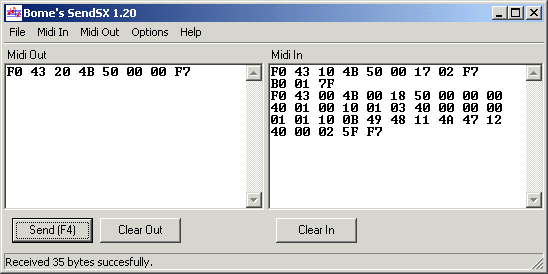

Hi buddy ,
you can download the extra banks from access website, they should be inside the OS Update file.
The easiest way to do this is to use Sendsx and transmit the SYX or MID file to the Virus, no need to use any DAW or midi-ox.
1.open sendsx and set midi ports correctly.
2. connect both midi IN/OUT of virus to your midi interface
3. load the extra banks SYX or MID file to sendsx. Dont use the partial files , just load the big file only.
4. Press send :P
If you get any errors during the transmission then decrease the midi transmission speed.
Let me know if you need more details

installed Bome's SendSX 1.30
ps: i'm using Windows 8 64bit
additional info for anyone else out there:
- to put the Virus in "update mode" power up while holding "STORE"
- set the Virus to "RECEIVE"
- it will then will read "RECEIVING UPDATE waiting for data"
- if you want to load a new OS...open and send file "first_c_650x352"
(send on Bome not on Virus)
- if you want to load the expanded banks E-H....open and send file "virusc_second_1024"
(data transfer takes about 10 minutes)
- at the end of the data transfer (the Virus will ask you to accept or reject changes)
STORE = accept changes
SINGLE= cancel changes
then just wait 'til the Virus cycles through and accepts the changes.

I spent many hours to find the way to update my Virus B (slow tempo, change my midi set up, etc...), because I had everytime "Checksum Error" or "Block incomplete" messages on the synth.
I had to select the option on Bome, "Split long Sysex messages", and it worked perfectly.
Hope this could help.
