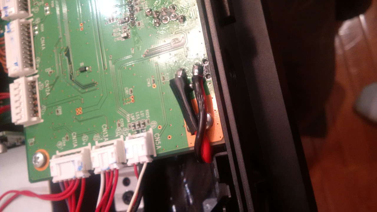

The CONN housing is correct for the supply output, but it DOES NOT come with pins! So I ended up just soldering to the generous pads on the bottom of the board instead of finding pins and using the housing.

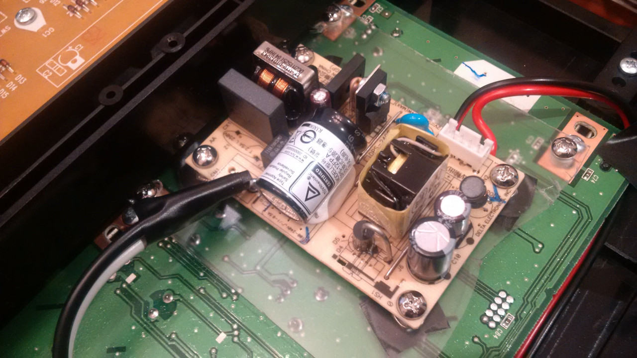

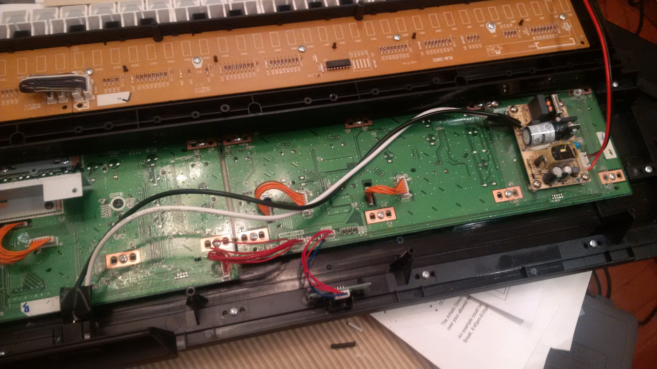

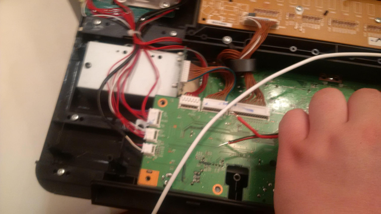

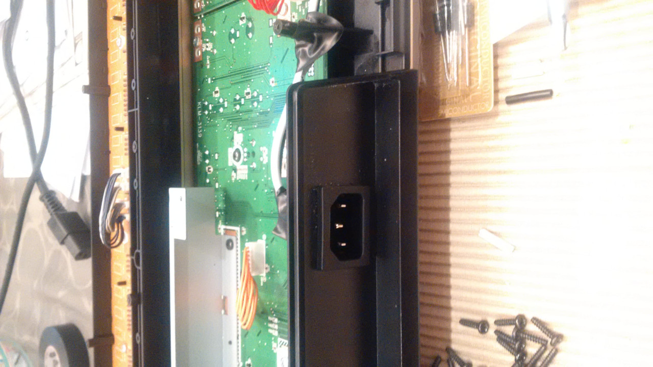

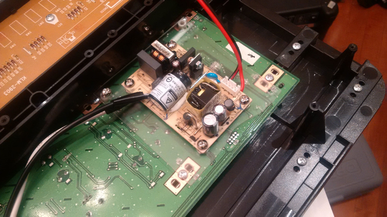

With that all aside, mounting was straightforward. After assembling the iec connector and wires (with the ground sheath connected to ground on the connector) I mapped and routed a hole at the far side of the output panel. I then ran the wires through and popped in the iec connector. Next, I soldered all of the wires to the board (there was a connector for the mains side but I opted to remove it as the female part was not available from digikey until October. Very annoying). Then, mounted the board to the adaptor plate using screws, spacers and nuts. I noted that my spacers weren't quite tall enough to keep the nuts from shorting the panel board below (for the space between the adaptor plate and the panel) so I stuck electrical tape on each nut to keep it isolated. Then I removed the keyboard and stuck the adaptor plate with the power supply on the premade mount points I had measured for with spacers and screws. I wanted to mount it the other way, but I screwed up my measurement for the mains cables and thus it had to be flipped so mains was coming in on the middle and DC came out towards the case edge. There was ample room to run the wires neatly in the belly of the case. I then stuck a diode on the positive cable in case somebody decided to plug another 14V adaptor in while the mains was also plugged in. I considered adding a diode to the DC input as well, but I wasn't so concerned with protecting wall warts, especially since it is an unlikely scenario to prepare for and very annoying to do (it would involve snipping one of the jack's posts, and soldering a diode across the gap. It would suck). Then it was just a matter of soldering the DC leads to the jack's points and I was done. And it works like a charm! Super easy and accommodating. I very much enjoyed working on this synth. Maybe I'll revisit adding those jacks another time, if my friend wants them.

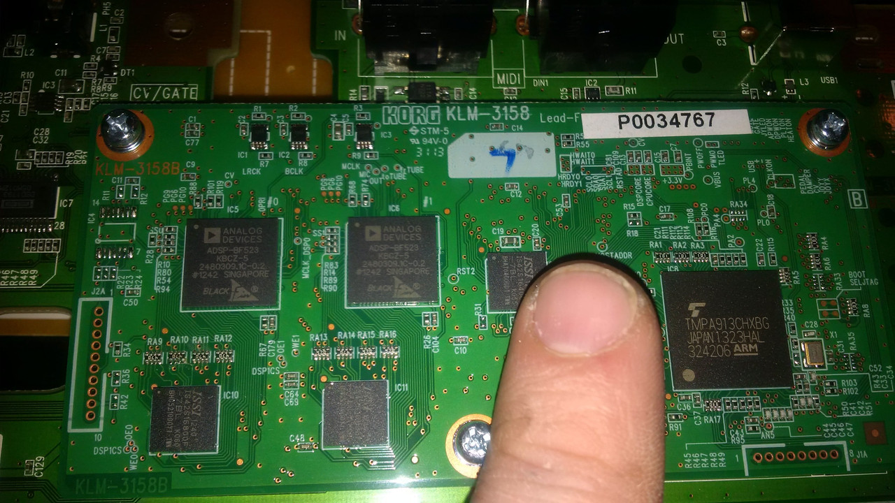

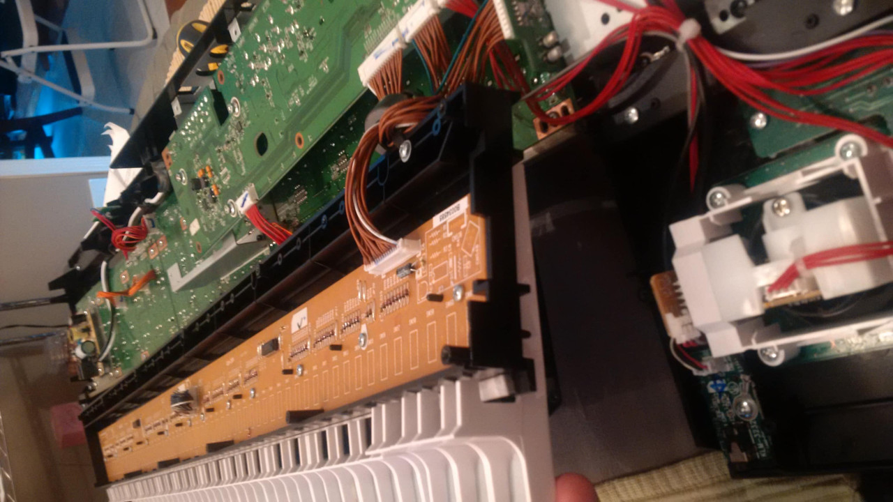

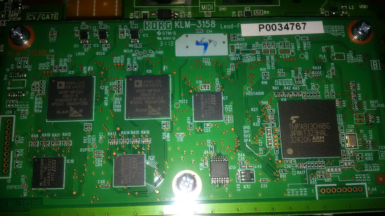

Everything is surface mount and TINY! I was in shock when I opened it up.
This is the entire SYNTH part of the synth including two effects chips on the left. It is a small auxiliary board on top of the output board and is unbelievably small, considering that a synth used to be defined in size by how much space its internal parts took up, not what size the keyboard was going to be. All of the other boards are panel boards for handling the screen, buttons, and knobs or for input devices.

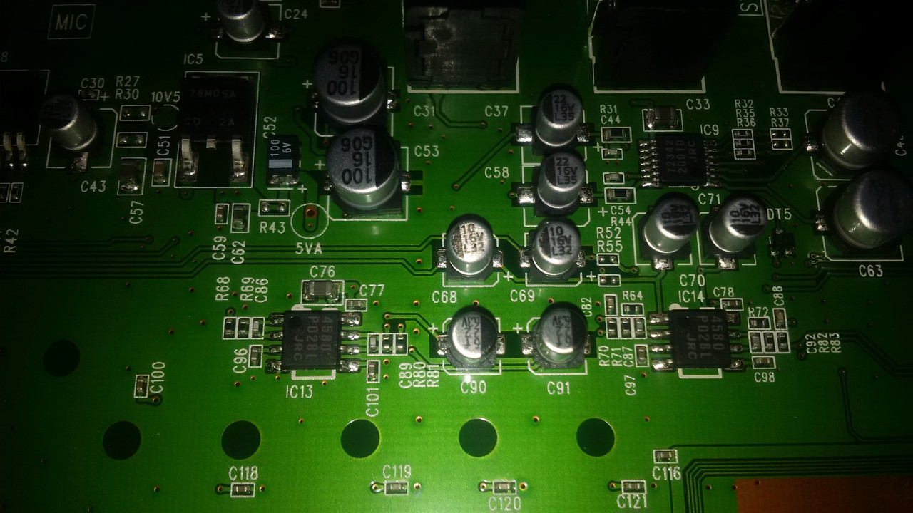

I took this picture when I was trying to find out what the op amps on the output were. I *thought* they were the problem. Thank god they weren't. I can't imagine replacing surface mount madness.

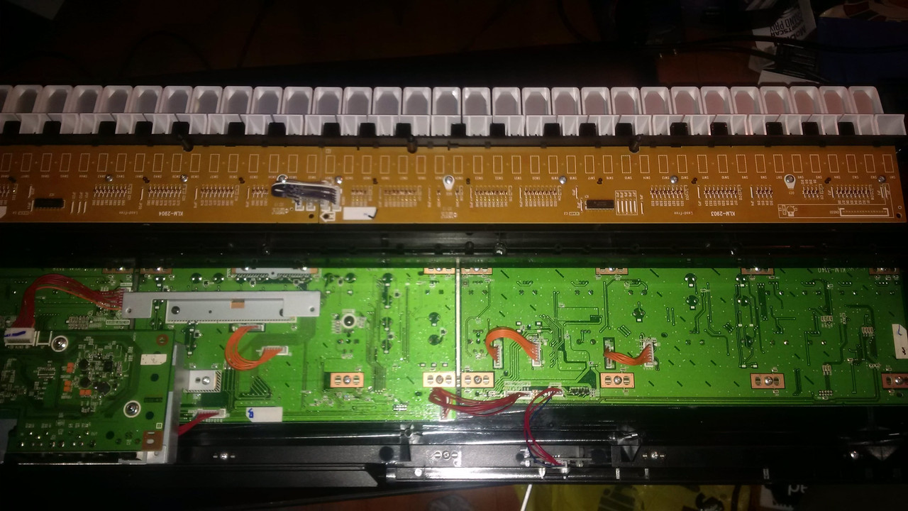

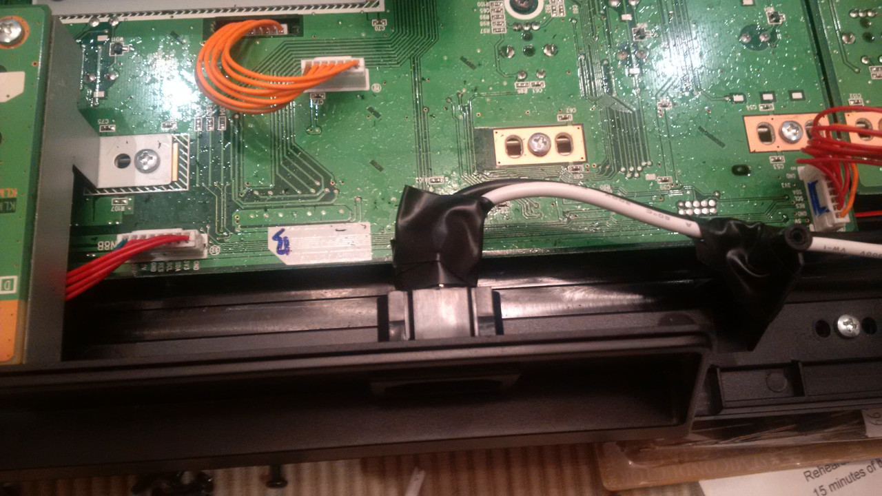

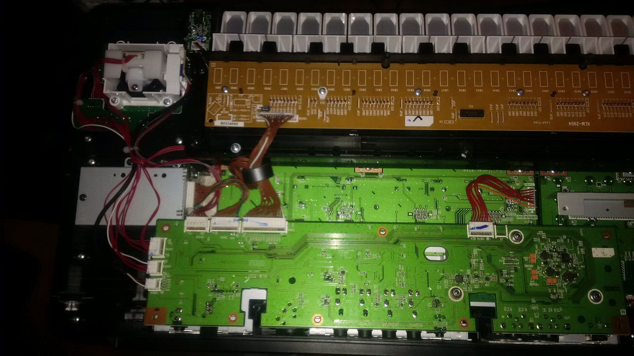

A general overview of what I did. Note all of the open holes at the edges of the panel boards. Korg implemented "screw rails" which ran the length of the board mounts. I had never seen this before (I am still pretty new at all of this) but found it extremely handy.
The case was modular in design. There was the "bowl", the bottom of the case which kept everything together, but then the gold section with all of the panel controls was separable from the output panel, which included the synth itself (but on a satellite board so technically that was removable too), the cheek with the bender was also a completely separate piece, and so was the keyboard. They were held together with minimal screws making service a charm. I would assume if anything got sent back to Korg they'd take the bottom off, throw out the defective module, and stick in a brand new one, like a piece of cake. Even the tube was in its own modular section.
Here are some pictures of the final product.
