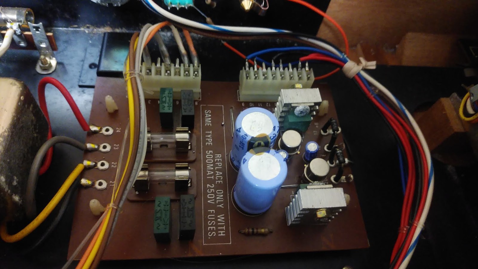

The PSU looks okay visually... but...
Okay here is the positive voltage:
And now this this should be negative, but it's totally off!!! It should be -15v on these pins.
Yes, I am consulting the full 40 page manual. It's the best scan I could find, but it's still quite hard to read.
I've been reading the mezzoauto blogspot since I've bought this synth. That Sh2000 post had lots of really interesting analysis. It's kind of hard to find info on this synth, it's really overshadowed by the other Rolands in its family.
So I shall be recapping this as soon as I can and I'll let you know what the result is. Thanks again!

Re: Bring Roland SH2000 back to life?
Ok I've checked the PSU voltage again after unplugging everything, and it's totally the same voltage readings.Yekuku wrote: ↑Fri May 08, 2020 8:46 amDisconnect the psu from the mainboard and check the voltage again, if the voltage is right , a shorted component might be dragging the negative voltage line to ground.
If the voltage is still down check the bridge rectifier ( green diode boxes), the caps and the regulators.
But I have an idea, the power switch is a dual pole / throw, my bet is that one contact is dirty thus not powering the negative voltage line.
CHECK AND CLEAN THE SWITCH !
To test the switch, unplug the synth from the mains, engage the switch and use a multimeter's continuity to check the connectors pins
(1) & (5) should be 0 ohms
(3) & (7) should be 0 ohms
Spray a bit of WD 40 inside the switch to clean it.
Attachment updated.
Attachment updated.
Ok I tested the switch pins for continuity and got beeps for both poles. No ohms showed up on the multimeter. The solder joints look quite crusty, but I've seen worse. I think I'll re-flow them.Yekuku wrote: ↑Fri May 08, 2020 5:27 pmTo test the switch, unplug the synth from the mains, engage the switch and use a multimeter's continuity to check the connectors pins
Attachment updated.
I believe I know some equivalent to WD40 in Japan. WD-40 is lithium based right?
I am not sure if it is lithium based, any contact cleaner with lubricant will do , no need for WD40.
If there is continuity , the switch works, no need for losing your time with this.
OK, now that you have ruled out the switch, you should check the transformer.
Based on the previous attachment , take VAC readings on the 2 secondaries, you should read near 20V on both windings.
CAUTION: playing around with transformers could be lethal !
Edit : have you checked the fuse F602 ? if it is good , remove it and check the holder for oxidisation, then reinstall. Then remove D603 and D604 and check them, they are double diodes , the orientation is printed on them, they are easy to test. Also check diode D606 for short.
