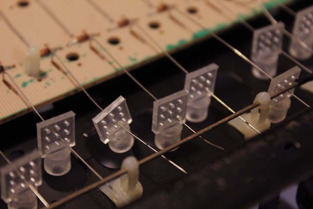

Missing part for for J Wire Keyboard - What is name of part
Z
Posts: 3564
Post by Z » Tue Sep 18, 2012 1:15 am
And where can I buy more? It's the clear plastic thing that the J Wire goes through. See image below.
V301H
Posts: 768
Joined: Tue Oct 23, 2007 3:58 am
Gear: Fender The Strat, Stratocaster, Jazz Bass Rickenbacker 360-12, 320 Messenger(Mark Farner)
Band: The Characters
Location: New Jersey
Re: Missing part for for J Wire Keyboard - What is name of p
Post by V301H » Tue Sep 18, 2012 2:58 am
I've seen these called contact holders. Also might be called J-wire guides or something similar. You have a Pratt-Read keyboard which is one of the most common found on American vintage Synths and some Organs. There are online sellers of replacement Pratt-Read keys, bushings, and J-wires but none of them list this part. You might try Sound Doctorin and see if he has any. http://sounddoctorin.com/synthtec/parts/key.htm
Prophet 5 rev.2, Pro-One, Juno 60, Jupiter 6, Matrix 12, OB8, MS20, Poly 800, CS70M, DX-7, CP35, Casio PX-5S, Hammond C3/M102, Vox Continental/Super Continental, Gibson G101, Farfisa Compact, RMI 300A, Pianet N, Combo Pianet, S770, S760, S50, NS3C
synthparts
Posts: 779
Joined: Sun Oct 09, 2011 12:05 pm
Location: SF Bay Area, CA
Post by synthparts » Tue Sep 18, 2012 10:10 am
They are called j-wire guides and I have some. PM me how many you need...
