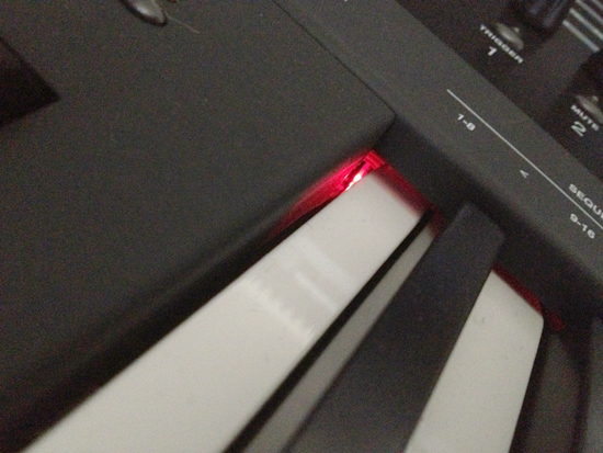

Another cool thing I noticed is a red light on the board of the Accelerator.
I've never seen a synth open and powered on so maybe this is no big news to electronic savvy heads.
But to me, I never expected there to be lights on a board that weren't LED related.
And as far as I know, there are no RED indicators anywhere on the accelerator so what purpose do they serve?
So I see this red light in the crease between the keys and the housing.
Should I NOT be surprised?

Re: Weird Audio Problem(s) Ugh Oh
FIRE IN THE HOLE!!!! Set your FX units to "WET"!
Yes, some ancient Korgs did have a led for each voice (on the circuit board) to help troubleshoot.)
On the Microkorg, a realy big problem today is the crappy plastic jacks the everybody uses. The atom-thick plating on the contacts wears off in about 90 days. Any side-pull on the cable can crack the plastic, or bend the contacts.
Best move is to replace.
Are your cables hosas? Those tend to go bad after a little abuse, sometimes go bad on their own after a while, but I keep buying them cause I can get 3 or 4 sets to one monster. Anyway, there are also lights on the old Oberheim voice cards too, don't know about the RT stuff, never seen any lights peaking through any cracks on my Speckie, but if it is a concern you should ask on their forums. Jorge use to respond directly if nobody else had an answer, but it has been a while since I've been over there.
Thanks for the replies.
Yes, they are the Hosas and I years ago I saw a bundle on sale, the one where it's a huge snake set and I broke the insulation and separated all the cables.
So yeah, replacing them is next. I'll post on radikal about the internal board light.
