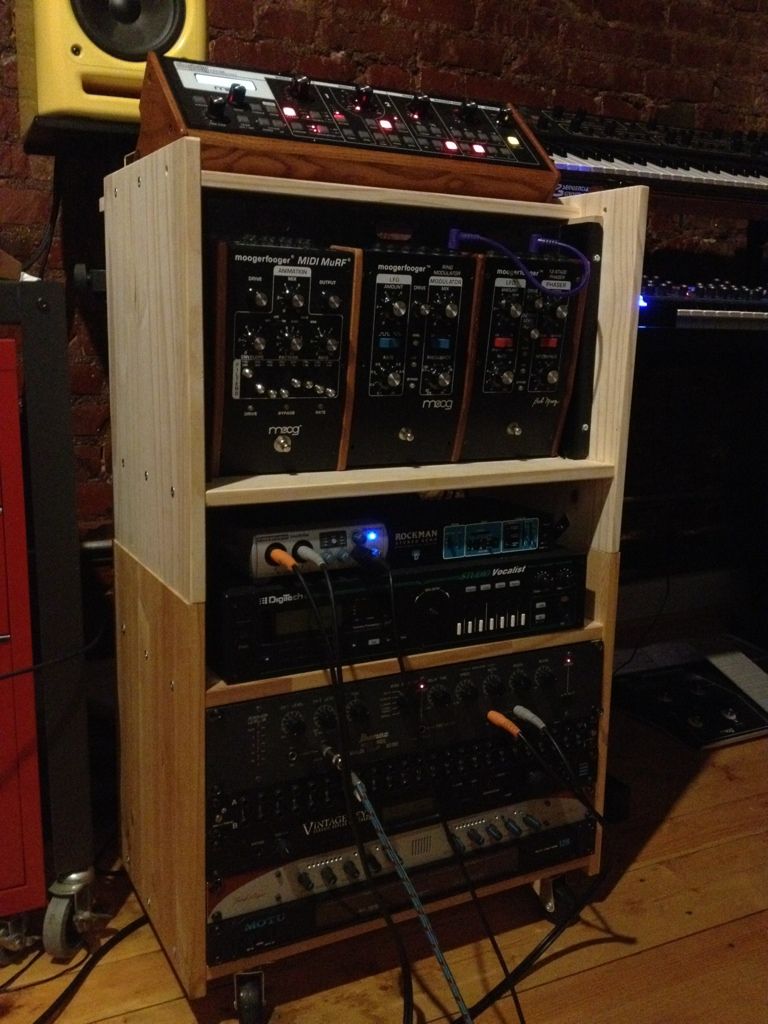

Would this ikea rast work as a 6u? http://www.ikea.com/us/en/catalog/products/44361109/
Seems like a few people have successfully modded that to work.

Jabberwalky wrote:Would this ikea rast work as a 6u? http://www.ikea.com/us/en/catalog/products/44361109/
Yes it's perfectly 6U already from the shop, you just need rails and power. I have two of them (for normal rack gear though, not modular - not that it would make a big difference).

Jabberwalky wrote:Great news pflosi! Looks like I'll be stopping there this evening
I got a second, flipped it over and attached it to the first for even more space.
Then I got some casters so I can move it around when needed.
I wonder if Ikea is aware of their perfectly designed rack! I bought one last night, seems sturdy enough (for being pine). Did you buy rack rails GuyaGuy? It looks like your lower gear is inset into the table. It looks like I'll be going with the TipTop Happy Ending on the bottom. ;)
The bottom row has rails. The top (Moogers) just have spare wood blocks for rails. The middle stuff is just stacked up--nothing is screwed in.
Some different stuff is in there now though; the photo is a few months old after all. ;)
